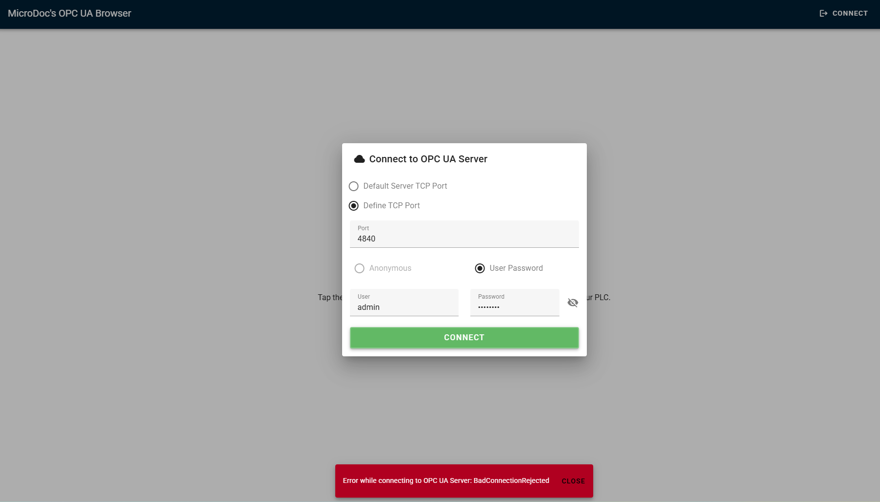

I have installed the application MicroDoc’s OPC UA Browser, and now I am getting the error: Error while connecting to OPC UA Server: BadConnectionRejected.
I do not know what I should do.

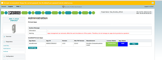

I am using axc-f-2152 PLC.
