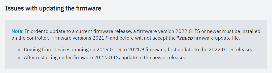

Regarding the firmware update, please note this information in the Info Center:

Regarding the firmware update, please note this information [in the Info Center</a>:</p>[https://forum.plcnext-community.net/uploads/RKYJY7RGI9PZ/image.png</a></p>
Hi Martin,
Regarding the firmware update, please note that I followed the instructions as per the information in the Info Center, but the firmware is not updating. I have attached images for your reference.
Thank you for your assistance.

Unfortunately it’s not possible to update the firmware on an AXC F 2152 using a raucb file for an AXC F 1152.
User: “image.png”
Please try a raucb file for the AXC F 2152.
