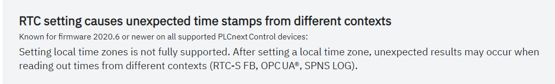

Hello, yes, something like this has been reported in the past, and it is recorded in the current list of Known Issues in the Info Center:
This is an unusual error because, as you have observed, the behaviour seems fine for some time zones, but not for others.
The issue is expected to be fixed in firmware version 2024.6.
