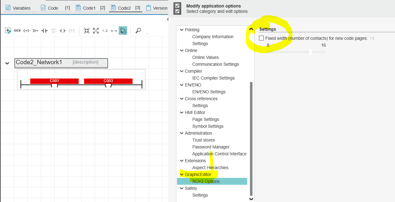

Hello, Is it possible to change the standard length of a Ladder branch? From first contact to coil is so far that you need to zoom out until you can barely see the text even if you just have one contact and coil.
Thank you, Seems like its only possible on new programs.
