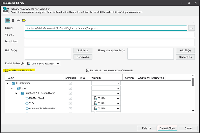

I am experiencing a problem with including GSDML’s in libraries. The issue occurs when a library that contains the GSDML is updated, the device definition is changed to „MISSING TYPE“. Any change to the library seems to cause this symptom in the projects that consume it.
Is this a known issue? Any suggested workarounds?
Hi Rob,
when you update the library, please take care of the Library ID setting.
When you only update the existent library, you should not create a new ID.
otherwise you will run into your described problem.
That did the trick. Thank you, Carsten.
