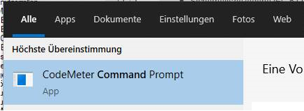

Open the Codemeter command prompt
Use the following command to delete the registration of the codemeter service
CodeMeter.exe /u
Use the following command to do a new registration of the codemeter service
CodeMeter.exe /u
