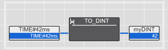

I suppose it simply prevents you cramping a 32bit TIME into a 16bit INT :wink:
It works when using a TO_DINT conversion.
Cheers
DivisionByzero
Hi fluxmodel,</p>I suppose it simply prevents you cramping a 32bit TIME into a 16bit INT ;)</p>It works when using a TO_DINT conversion. </p>[https://forum.plcnext-community.net/uploads/JD0QGRM3MRDV/image.png</a></p>Cheers</p>DivisionByzero</p>

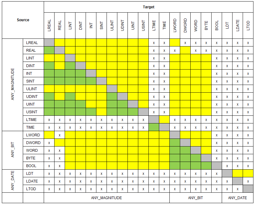

Anyways, I am confused that it works with DINT, as the conversion table in the help file (Home → Function/Function Block Reference → Implicit Data Type Conversion) don’t list is as a possibility:
Apologies, I pasted the wrong image in my previous post. That was showing the implicit conversion.

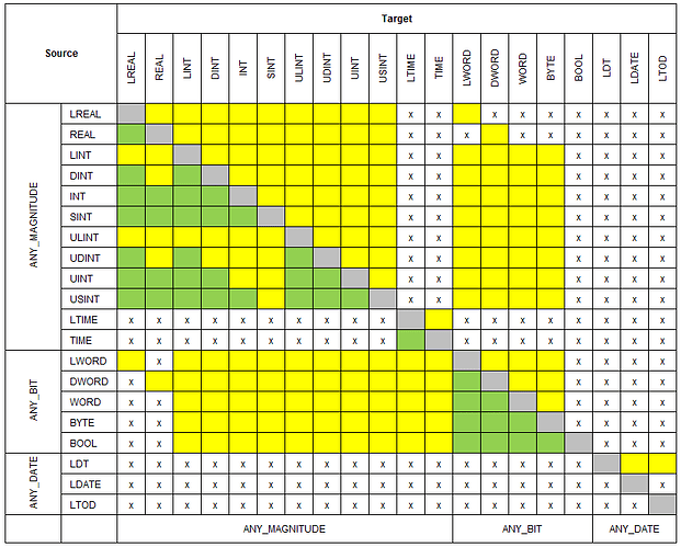

Here are the list with both implicit and explicit conversion possibilities:
(In the help file at Home → Function/Function Block Reference → IEC 61131-3 Functions and Function Blocks → Data Type Conversion)

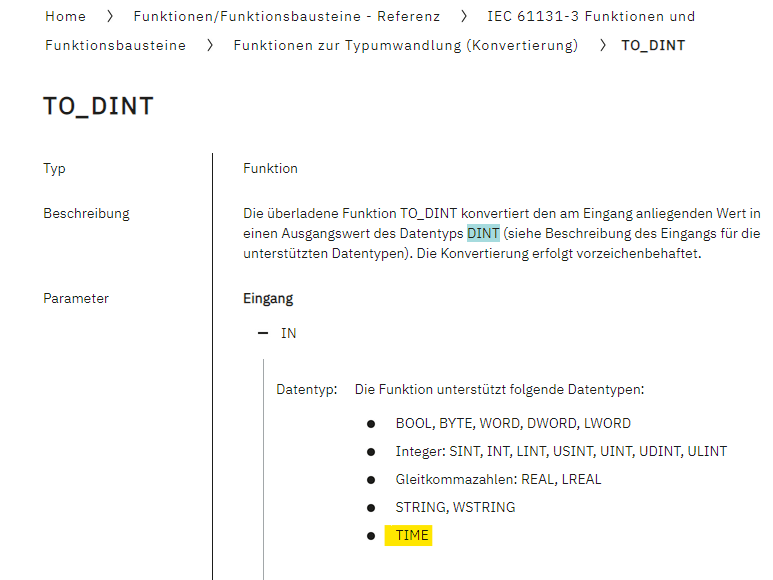

Maybe the table is outdated because the help for TO_DINT shows TIME as a valid input
