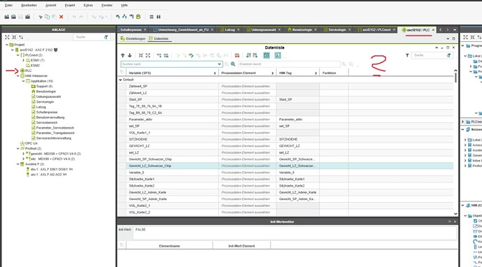

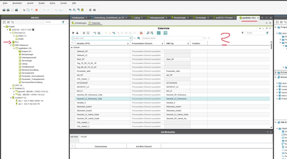

Issue was similar as to your screenshots. I borrowed the technique to deploy PLCnE projects trough docker containers.
Seems to work fine
