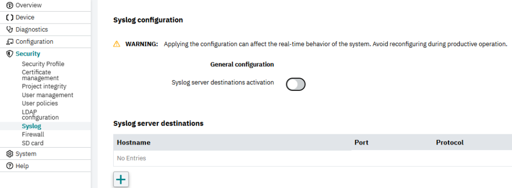

Is the syslog server active on the AXC F 3152?
Hi, Tim!
Well, the syslog server is active by systemctl status syslog-ng@default:

Syslog server destination activation is off, as in your image.
