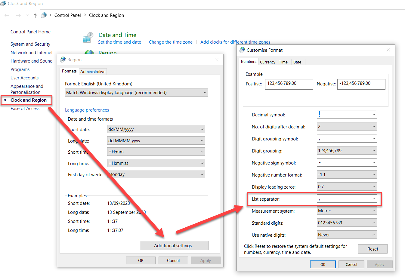

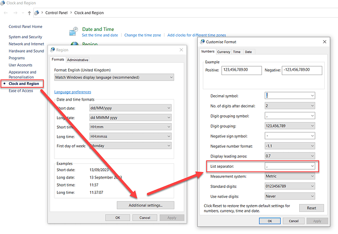

Hi Markus, I haven’t checked it, but does this windows setting help to work around that problem?
(i.e. change the list separator to something other than a comma).
