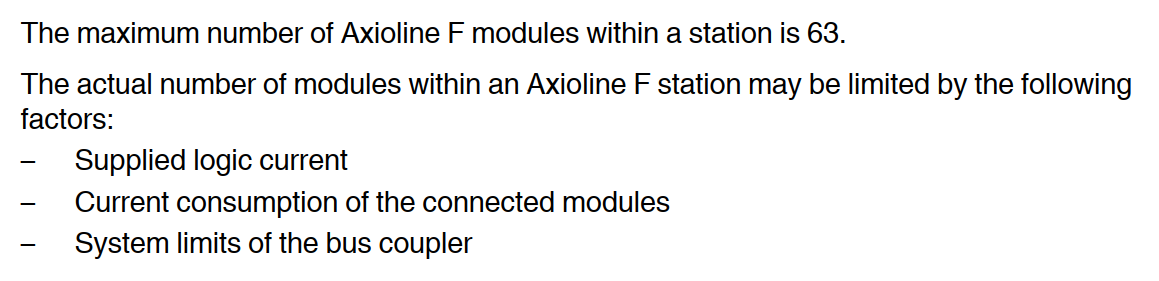

From the Axioline system and installation manual:
… so in theory you could have 63 AXL F CNT2 INC2 modules on a single Axioline station, and there can be multiple Axioline stations in a project (by using Axioline bus couplers).
