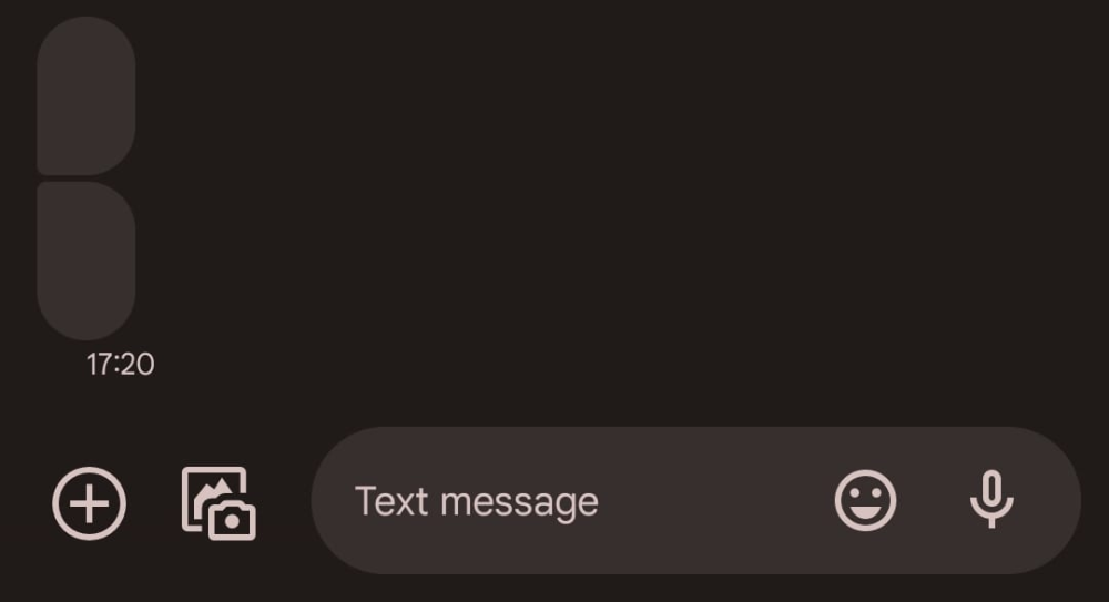

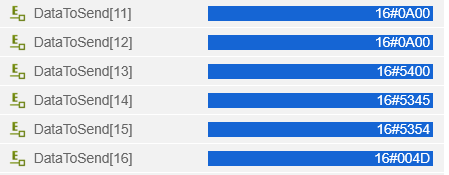

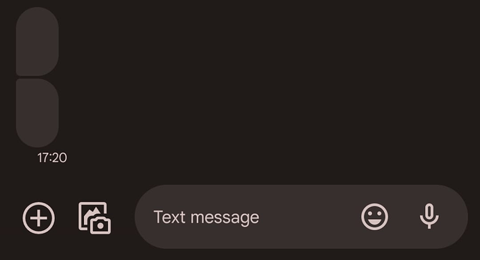

Received SMS (empty): In the ‘WATCHES’ bar I can see that some of the words have empty values (00):
Which means that there is a way to flip them (like using SWAP for example) but I can’t see how to do that without having to do it for every character for both strings. I guess my question is if there is a way to swap or rotate the words so that I receive the correct text. Thanks in advance.
Hi Ricardo,
maybe the ‘Endian’ functions are useful in your case?
Cheers
DivisionByZero
You might also be able to use the STRING_TO_BUF function block, which (a) will automatically strip the header bytes off the STRING variable, and (b) can be used to control the byte order using the BUF_FORMAT input parameter.
