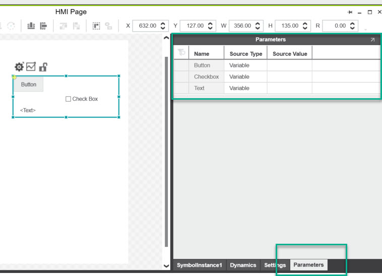

Dear All, I faced with unexpected problems with the parameters settings dialog in any editor. I can’t get access to symbol parameters via menu of symbolinstance, dynamic and static settings are ok, but there is no tab for parameters. Faced on PLCNext Engineer 2021.0.3 How can I get that settings? Probably there are some checkboxes, or etc. Best regards.
Just to clarify, are you referring to the eHMI editor in PLCnext Engineer?
Yes, eHMI editor. Excuse my spell checker…
Hi Oleksandr, I guess you are searching for a tabl like shown in the attached screenshot? This is available in the feature release of PLCnext Engineer 2021.3. Take care, Frank
