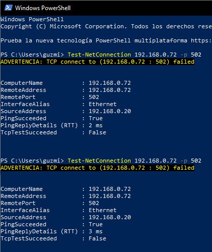

Hello Martin, thanks for the quick answer first of all! I tried pinging the PLC on its 502 port and the device is not reachable. It looks as if the PLC isn’t opening the port but that may also be caused by the Client FB not going Active. I’m not sure if the FB going Active would mean that the client is ready to receive or that the client has already connected. By the way, the PLC is reachable if I try to ping without specifying any port and the Modbus connection I’m trying so far is between the PLC and my PC with a Modbus tool, so we know that the connection exists between both sides since I’m connected to the PLC through PLCnext Engineer. Do you have any idea of what may be the cause of the 502 port not opening? Regards Guzmán

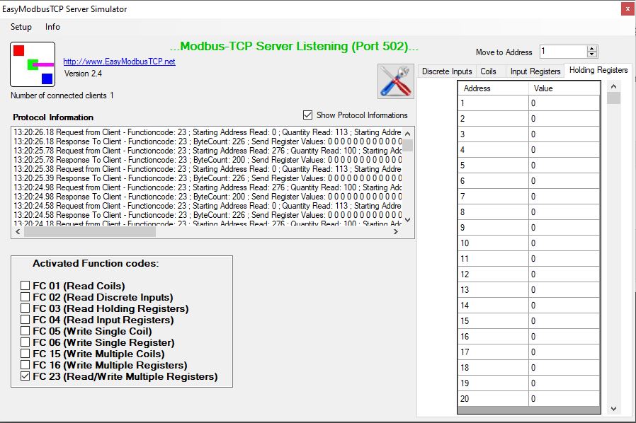

Hello Martin, The connection to the Modbus Server (old PLC) has already been checked with the use of the Modbus Poll tool. However, the old PLC is currently not connected to the client (PLCnext) because I’m trying to verify the programming of the PLCnext through a Modbus tool in my PC. Currently the only connection made is between the PLCnext and my personal laptop, which has to act as the Modbus Server to test the Client FB in the PLCnext. I have good news. I tried with several Modbus tools and finally got it working. I saw in another post of yours that Modbus Poll can’t act as a Modbus Server so I guess that might be the reason it didn’t work. Now I’m using a tool called EasyModbusTCP Server Simulator (EasyModbusTCP Server Simulator .NET/JAVA download | SourceForge.net) and the connection has been established with no problems. I have just one question left regarding the use of Modbus. Since I’m programming both sides of the communication, is it necessary for me to differentiate between Coils, Discrete Inputs, etc.? I thought that it may be possible for me to just send the array of WORDs from the old PLC (Server) and receive that array in the same order in the client (PLCnext) without having to worry about Coil Register Offset or anything like that. I say that specially because as you can see in the image together with this post, although I modify the content of the adresses, the only that sent to the PLCnext after the client asks for it are zeros. Thank you very much again! Regards Guzmán
