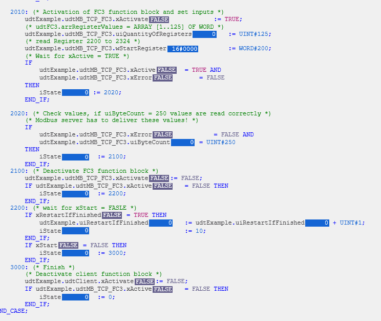

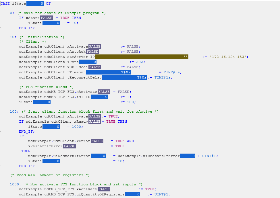

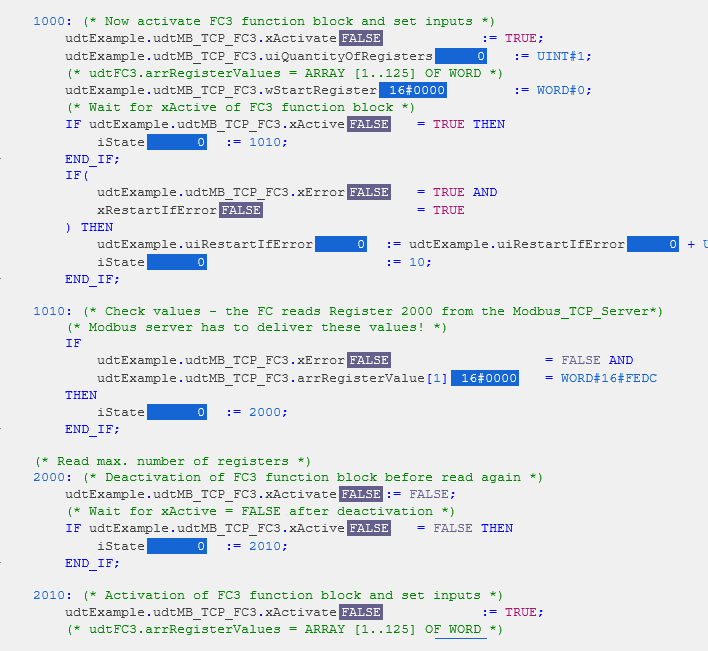

Hi, Thanks for your quick response. Answer your questions below: „Are you using the tool „Modbus TCP Server“ from https://modbus.org/ for testing of Modbus TCP client example?“ No, I am not using that Modbus TCP server. How can I get this tool? I can’t see download section. I am using „ModRsim2“ [quote]Are the Modus TCP Server and Modbus TCP Client in the same network subnet?[/quote] Yes. The PLC is not connect to the PC through ethernet cable but PLC is connected to the same subnet network than the PC. In fact, I am working remotly without problems. [quote]Could you send the screenshot or the description of the FB „MB_TCP_Client“ parameterization in debug mode and the settings of the TCP server simulator, please?[/quote] Yes, attached you can find the screenshots. Modbus Server doesn’t have any configuration possible, just your localhost IP and port.
Hello Hello seg_rolgar, I can see, taht you have not set xStart = True, in this example application. If your application is running, the iState should change the state (number). Currently iState=0, it means that the parametrization is not executed (the settings will be set in Step: iState=10). Please verify your start conditions. The https://modbus.org/ is the Modbus Organisation and is responsible for Modbus specificatiion and standard (https://modbus.org/about_us.php). The organisation developed the „Modbus TCP Toolkit“. It provides all the necessary pieces to develop a Modbus TCP/IP-compliant device, including documentation, diagnostic tools, sample source code, and pre-test software to prepare for Modbus conformance certification. You can bay this tool from modbus organisation or you can also use the „Modbus Poll“ Tool (listed in https://modbus.org/tech.php). Modbus Poll is a Modbus master simulator designed primarily to help developers of Modbus slave devices or others that want to test and simulate the Modbus protocol. I assume that the „ModRssim2“ tool can also simulate the Modbus server functionality, but it is difficult for us to support every third partry tool. Best Regards Eduard
Hi Eduard, Thank you for the response. If I change the value of xStart, the iState value changes to 100 and never moves from there… Modbus poll is just for Modbus master simulator but I need a modbus slave simulator, because of I am using ModRssim2. Anyways, using ModRssim2 and ModBus client simulator I can communication between them, so the problem must be at the client of PLC. Best regards,
