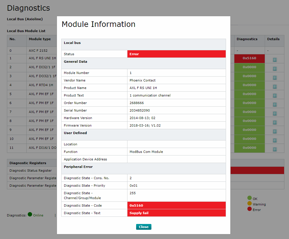

update:
I just saw on the wbm that it reports the error in the picture:
But the rest of the Axioline bus seems ok and operating.

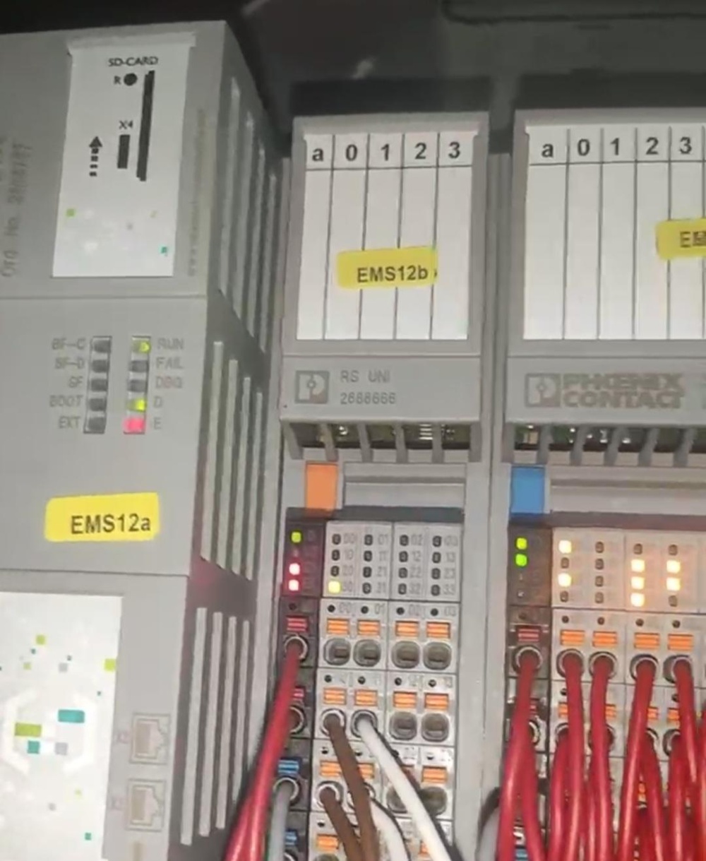

Also a pic of the status leds:
I am afraid that I don’t have an answer to your first question, but according to the user manual for the RS UNI module, the E1 and E2 LEDs and the error code all indicate a missing power supply for the RS UNI module.
