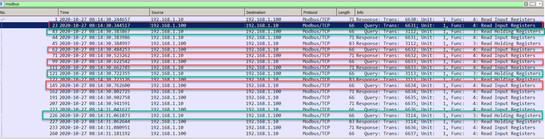

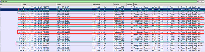

Hi Alex, A test has been performed here with PLCnext Engineer 2020.6.2 and AXC 2152 FW 2020.6.1 The project has one MB Client instance and one MB Server instance. Scanrate/Pollingtime ca 100ms of an external Modbus Client (Modbus Poll FC4 ) to the AXC 2152 MB Server FB Pollingtime of the MB Client (FC3) ca 250ms to an external MB Server (modRsim) See wireshark image in attachment Client: inline1364071960 Server: does not use Timeout for the MB Server (see help description for the timeout behaviour) inline 252337367 inline 2009051582

Hi Martin, I am confused with the time response from the wireshark.jpg attached by you above. Currently I have a POU page including two FC3, two FC1, one FC16 and one FC15 to read a third party Modbus server. They have to be arranged with different iMT_ID input values. When I included this page to a 1000ms task, I count it takes nearly 20s to execute the first FC3 reading. I found that the FC blocks are executed one after another, and one FC block takes almost 3s (Does it take 3 cycles to do a poll reading? like 3*1000ms?). The total time will be like 6 (FC blocks) * 3s = 18s, in my case it is almost 20s. Please teach me if my understanding above is correct or not. Thanks Jason Qiping Li
