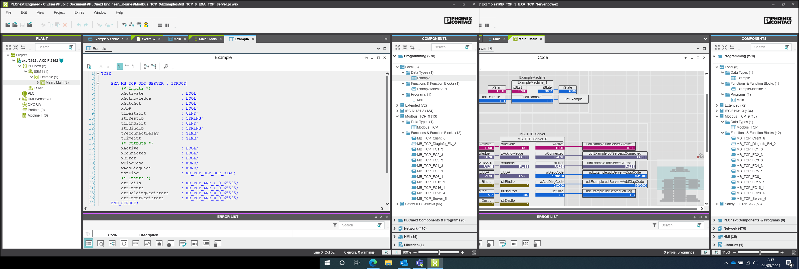

Starting with the Modbus TCP Server in the PLC - can you please post screen shots showing: 1. your Function Block instance with connected variables, preferably in Debug mode so we can see the variable values, and 2. your variable sheet showing the variables that are connected to the function block instance? So we can see the type of each variable. What version of (a) PLCnext Engineer and (b) PLC firmware are you using? What is the IP address of the PLC and the Modbus client machine? Can you successfully ping the IP address of the PLC from the modbus client machine, and vice-versa?

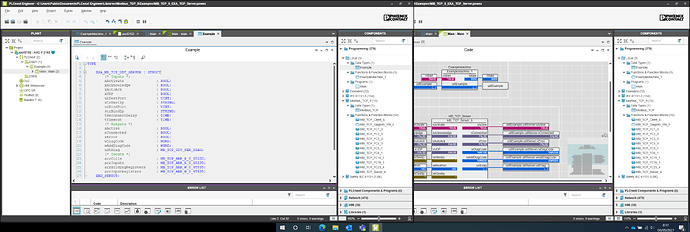

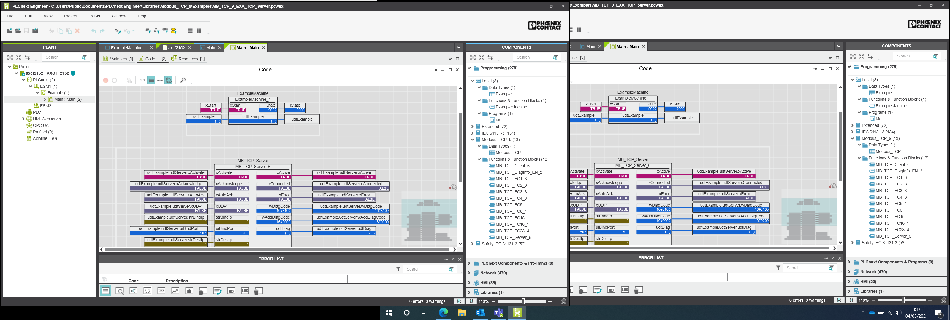

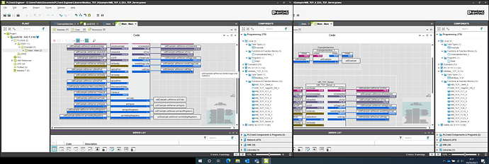

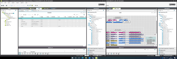

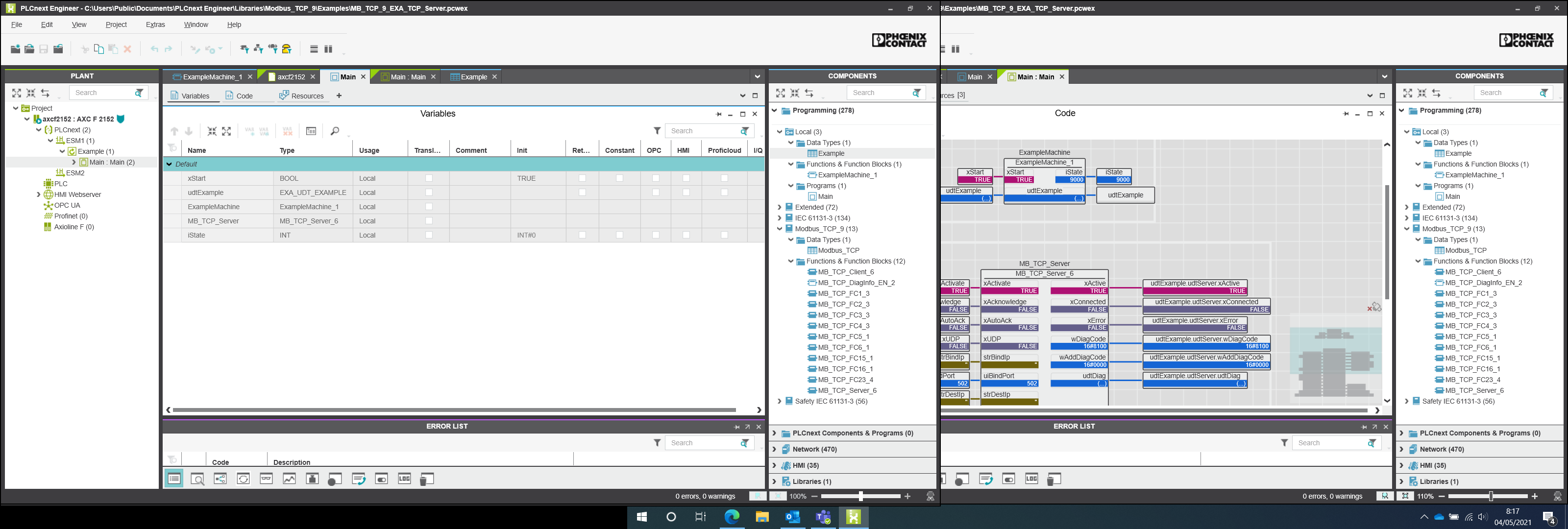

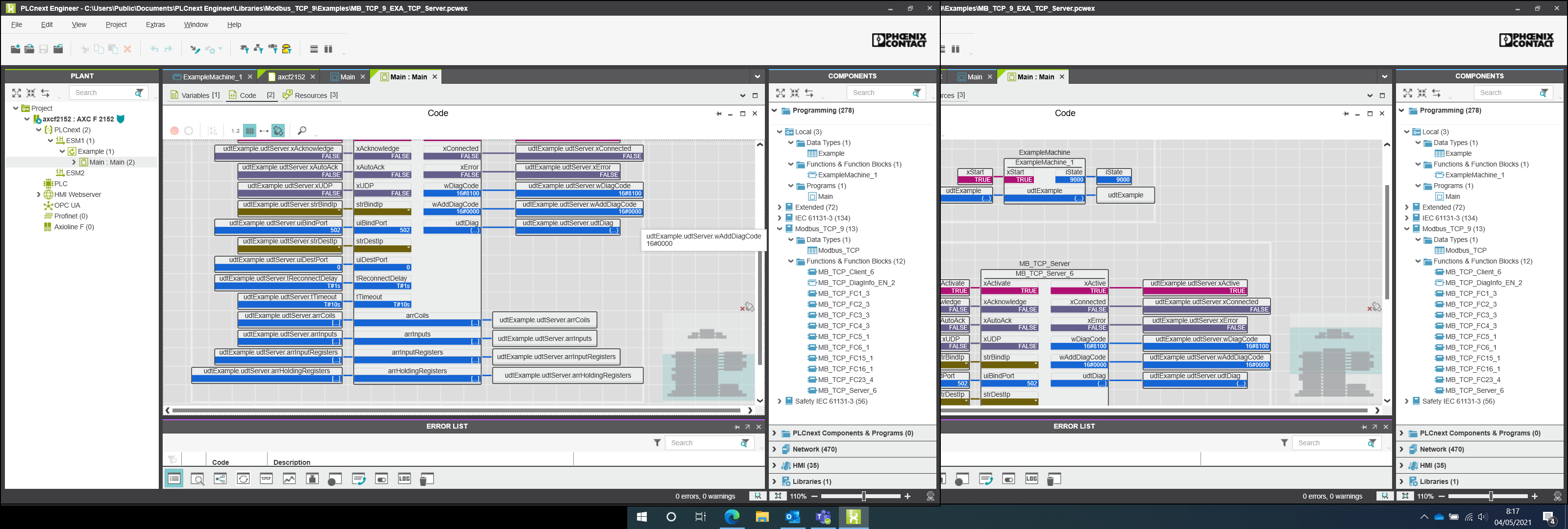

Thanks for the response. Attached you can find the screen shots. Versiion PLCNext Engineer: 2021.3 Firmware: 2021.0.3 LTS (21.0.3.35554) The IP address of the PLC is 192.168.1.10 and Modbus client machine is a simulator, running on the localhost. I can succesfully ping the IP address of the PLC from the localhost. I have worked correctly with digital I/O even inside HMI interface. Regards,
