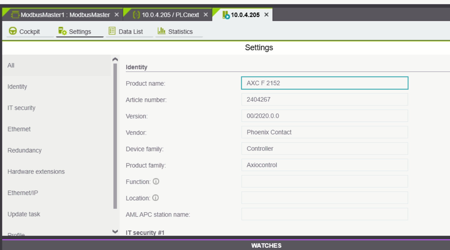

I have another question, perhaps you can help me. I was using 2020.0 LTS Now I installed the PLC next engineer version 2021.3.1 Do I need to upgrade the PLC firmware?

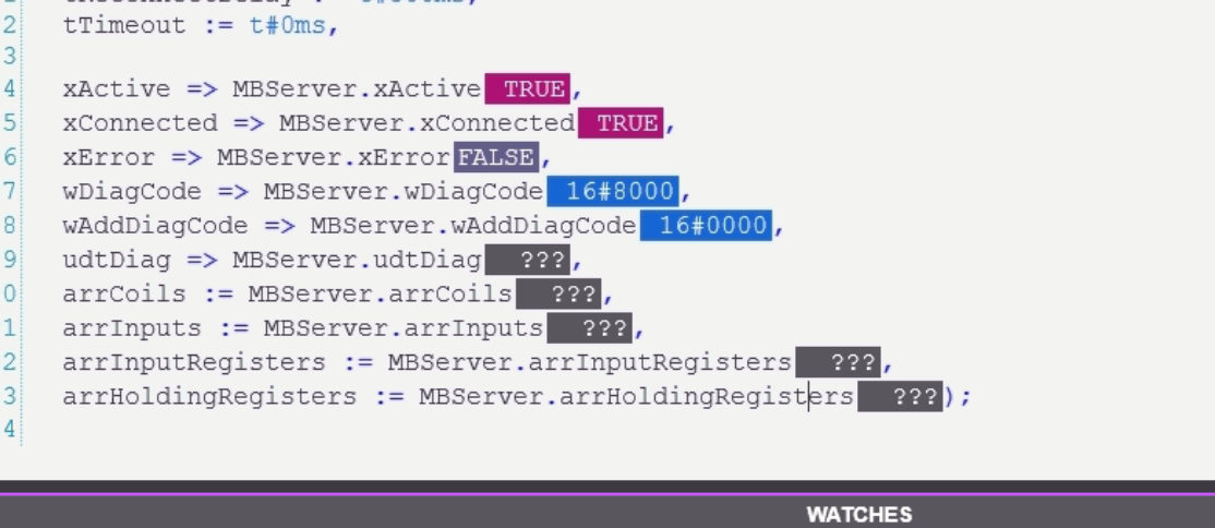

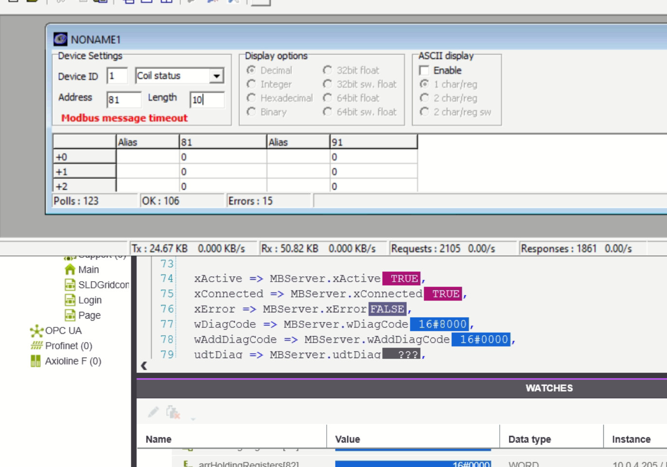

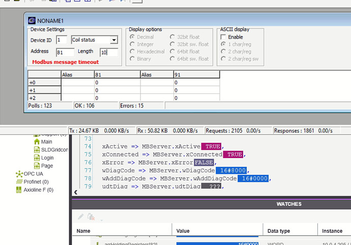

One more problem. Is seems that the server dies at some point, but it does not show any error, in this state no data can be requested to the server, see attached image.
I will need to put all those questions to the developers of the Modbus TCP library, but it will be Monday before they see the questions. It is also possible to contact the developers directly using the “Contact” button on the PLCnext Store page. I can answer one question: [quote]I installed the PLC next engineer version 2021.3.1 Do I need to upgrade the PLC firmware?[/quote]Short answer: No. However, it is always recommended to keep the PLC firmware upgraded to the latest LTS version, at least, to get the benefit of security improvements and other enhancements. Also please note the recommended PLCnext Engineer versions for the different versions of the Modbus TCP libraries. The developers will probably recommend that you use exactly the recommended version (no earlier and no later).

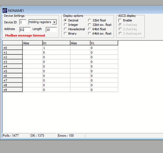

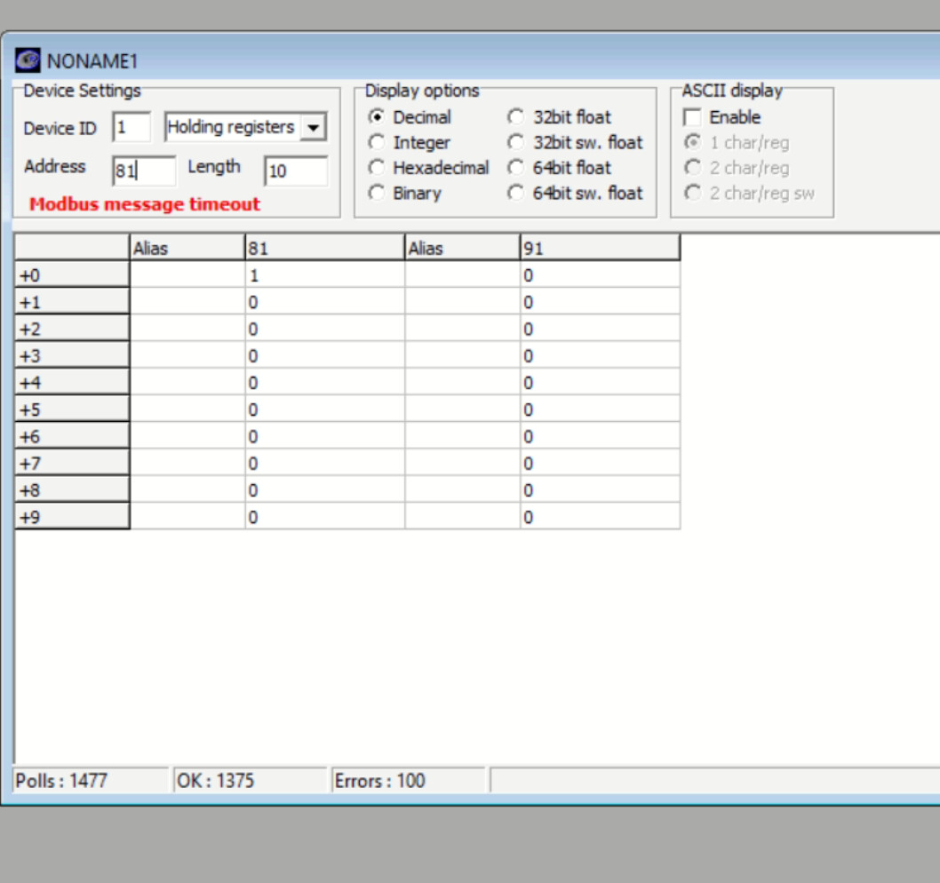

Hello, I have tested the new version, it was a bit more stable. here are the metrics. We still get errors. we are running requests at a second level to a meter which is next to the PLC and we have gotten 0 errors so far, and the PLC shows 9 errors over approx 65000 requests. The PLC server on the code itself does not record any error flag, but it’s not possible to request data at some point. Also, interesting, that the response time for the Modbus message is not constant, it ranges from 200ms up to 1900 ms. Finally, after testing for one entire day, the server becomes unresponsive, it dies but shows no error, so you basically can request data to it but on the code it seems that everything is fine… I think the last point is really critical, since there is no acknowledgement of error from the system, this library shall not be used. Any hint? on how to solve? The test was performed PLC engineer next 2021.3.1 Modbus TCP 9 library PLC AXC_F_2152 - 2020 / hw 02
