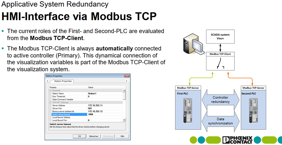

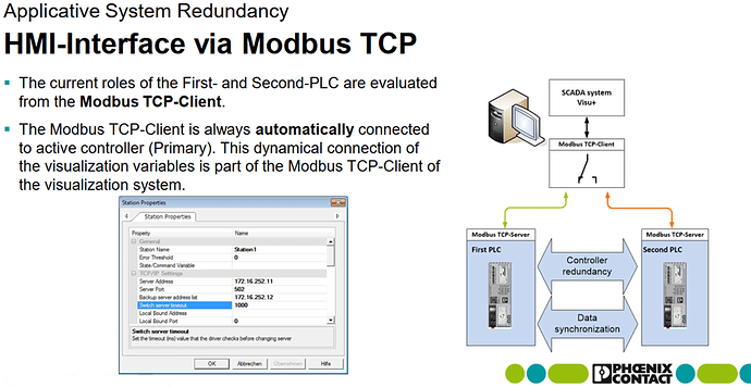

At our visualisation system, for example, you can enter at the Modbus TCP Client configuration the Server IP-address and additionally a Backup IP-address:
Hello,</p>At the ASR system there are two PLCs forming a redundant system. One PLC is named FIRST and the other is named SECOND. One of those PLCs has the redundancy role Primary and the other has the redundancy Backup. In case of a redundancy switchover the redundancy role will be switched.</p>The IP address assignment of the PLCs does not refer to the redundancy role but refers to FIRST or SECOND respectively.</p>If you communicate via Modbus TCP Client and there is a redundancy switchover of the PLCs, you will have to change the Server IP-address of your Modbus TCP Client configuration.</p>At our visualisation system, for example, you can enter at the Modbus TCP Client configuration the Server IP-address and additionally a Backup IP-address:</p>[https://forum.plcnext-community.net/uploads/0OJINVWPIFDT/image.png</a></p> </p> </p>
