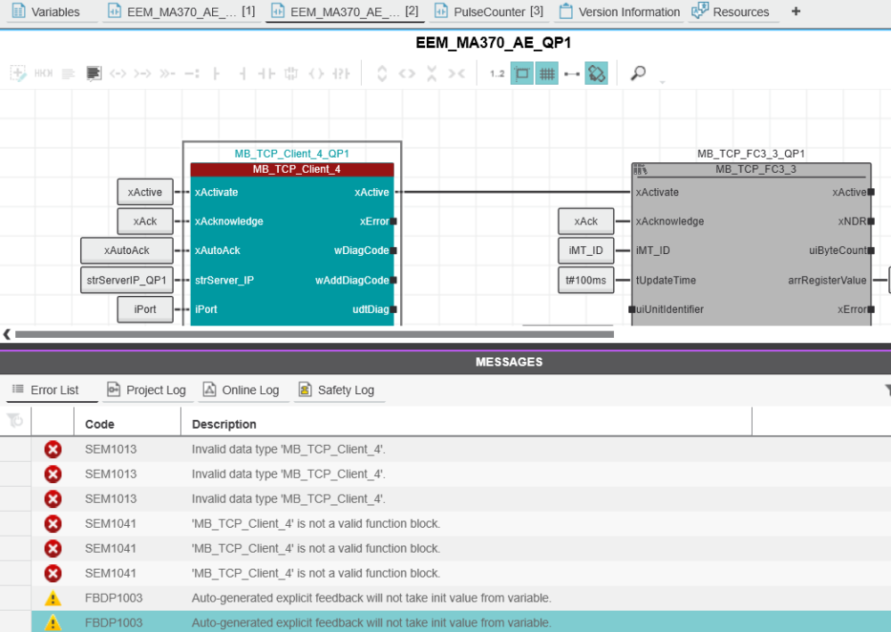

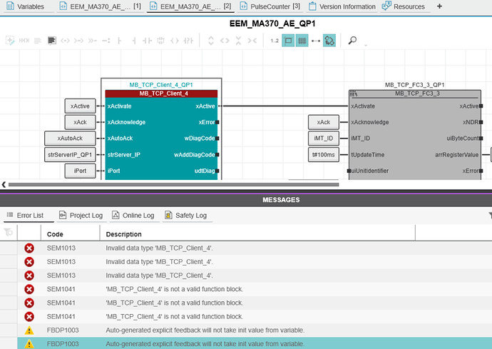

I need the array ModBusData from the ModBus TCP Server 4 (library Modbus_TCP_7) in another function block. In this block I want to read and write elements of the array. (see attached images) I am aware that for an internal array I have to make a struct for a new datatype. → https://github.com/PLCnext/CSharpExamples/blob/master/PLCnext_CSharpExamples/04_UserArray/FBWithUserArray.cs But to connect the ModBusData Array to my function block I need the same datatype. Which is not the case when I create my own datatype. How can I use the ModBusData Array in my function block? Or is it possible to split the ModBusData Array into words and put them as input to my function block? If so, how can I do the separation?

I currenttly use the following program. Can you tell me what is wrong? I can make the connection in the PLC with the datatype “ANY” but I still do not see any changes in the Modbus.
