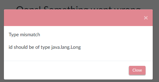

Hi Martin, My device is now online, but when I click install I get the following error: Type mismatch: id should be of type java.lang.log (see attached picture).

Hello, I will ask our store specialist to contact you to assist. Just for clarity, David was having problems installing the MQTT Client app, not the Mosquitto Broker - which I also installed yesterday on my PLC without any problems. In these cases it is not the app that is the problem, it is something between the Store and the PLC. Martin.

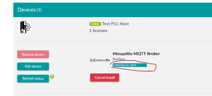

Daniel, Thanks for the reply. To clarify what I have done here is a list of steps made trying to install the app.
                                               1. Connected the PLCnext to my account and verified it was active in the WBM page of the PLC next and on my account page.
                                               2. Selected install from the MQTT mosquito app from the store.
                                               3. The status under my devices said installing 10%. I then clicked refresh status after a minute or two and the status changed to uninstalled 100%.
                                               4. I checked the PLC memory using an ssh session and looked in the apps directory and the installedapps directory and nothing appeared to be installed.
                                               5. After several minutes I checked the status under my devices and there was no change.
                                               6. I clicked cancel install.
                                               7. Repeated steps 2 to 4.
Based on your reply it is a problem with the connection with the store and the PLCnext. I will try another path to the internet and see it that corrects the problem. In the mean time is there a tutorial or read me on installing the app container? The note says you can use the WBM for install in a future firmware release (2020) but besides using an apt-get method and working out any issues is there a way to do an offline install using firmware 2019.3? Also if there is a better thread to post this please move it or direct me there. Thanks again for your help.
Hello Stubbs, thanks for your detailed description. From point 3 and 4 I can see, that the store is installing the app. But the device resists it. The reason can be found in /opt/plcnext/logs/Output.log I’ve just tried it out. the installation works for me. >>is there a way to do an offline install using firmware 2019.3? Unfortunately there is no convenient way to install a PLCnext app offline at 2019.3 yet.
