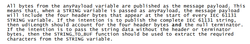

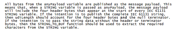

Hi Shane, you can ask the developers of that library for their advice (using the link on the app page in the PLCnext Store), but I suspect what you’re seeing is a result of this feature of that function block:
Here is the help for that function block: *_TO_BUF');\n mywindow.document.close(); \n mywindow.focus();\n setTimeout(function () {\n mywindow.print();\n mywindow.close();\n }, 1000)\n return true;\n}\r\n\r\n\r\n What did you try, and what was the result?

OK, that explains the error.
A STRING variable has four header bytes, as mentioned in the documentation for the IIOT library.
If you change the type of mqtt_message1 to an array of bytes, then the four header bytes will not appear in the buffer, and AWS should accept the data.
