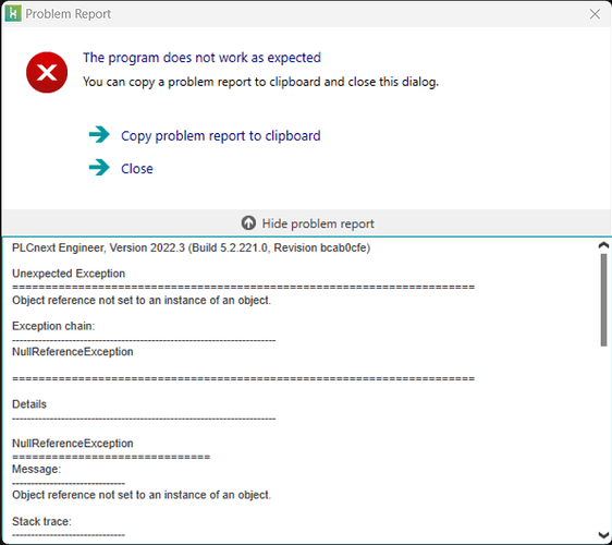

My PLCNext keeps crashing with an error
PLCnext Engineer, Version 2022.3 (Build 5.2.221.0, Revision bcab0cfe)
Unexpected Exception
Object reference not set to an instance of an object.
Exception chain:
NullReferenceException
Details
Message:
Stack trace:

hi, have you found a fix for this ? keep getting this error as well. I’ve tried to uninstalling PLCnext but it did not fix it
I found this in the change notes:
13.2 Fixed errors and limitations After an update of the .NET framework to version 4.8.1 PLCnext Engineer could crash when a tooltip has been dis\u0002played in an Intellisense drop-down list. The tooltips were removed from the affected lists to prevent the crash.
Maybe you should update to a newer version.
Cheers
DivisionByZero
thanks for the hint. Uninstalling Windows update KB5011048 fixed it for me. ( running plcnext 2021.6.2 )
