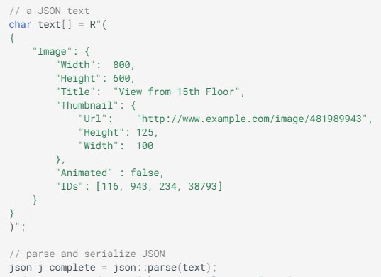

Hi Kelvin, CMake cannot find an nlohmann package, because nlohmann/json is a header-only library and does not have (or need) a cmake package. You do not need to make any changes to the CMakeLists.txt file to use this library. This works for me: - I included the header file (in my case, in the Program.hpp file): #include "nlohmann/json.hpp" - I used this code from the nlohmann documentation in the Execute method of my Program.cpp: using json = nlohmann::json; and: [attachment]2021-04-30_11-41-46.jpg[/attachment] (I have inserted this as an image because this Forum formats some source code in unusual ways). The above code gives a few warnings during compilation, but ends up building OK. Does the above code work in your program? ~ Martin. P.S. there are a number of other issues with your code snippet, unrelated to the json library, but you may be aware of these already: 1. If this program is instantiated in a cyclic task in PLCnext Engineer, then the code will be executed cyclically, at the period defined by the Task Interval. That might or might not be what you intend. 2. The curl GetRequest call will block the Task, and (depending on the Task time settings) will probably cause a Task Watchdog error. Please let us know in a separate question, if you need help solving these problems.
