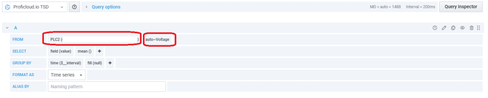

Hi Florian
No i couldn’t find the data at all in any part of the graph or when i used the gauge, below is the screen shot for TSD, i can see my PLC and i can see also my tag Voltage(assigned metric), but no value appeared at any moment.

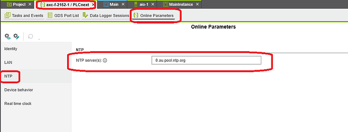

Finally i am able to send the data to the clouds, i did many changes and i couldn’t isolate what was wrong exactly, but the problem defiantly about time synchronising, below some steps i did to solve this issue and maybe other people benefits from them.
i make sure i have the correct time in my plc and use NTP
  • for Australia.
  • on the WBM

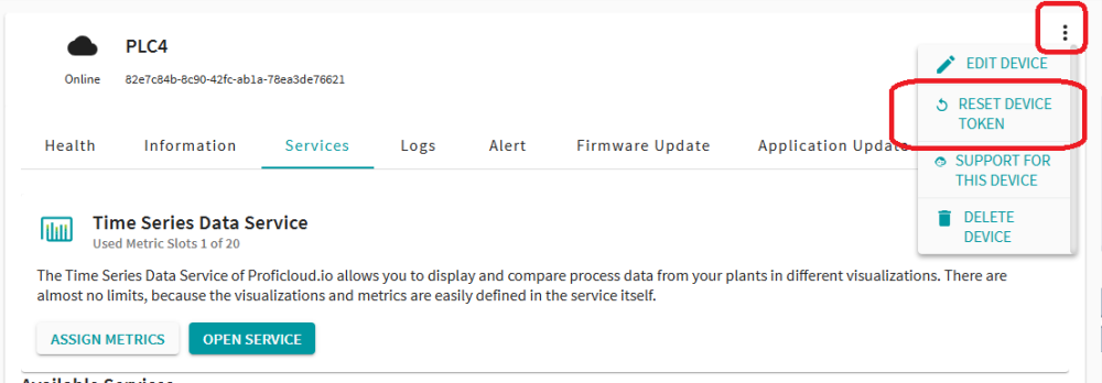

    reset Device token:
i tested these in three different PLC’s and all work, sometimes you need to wait for 1 minutes to see data stream.

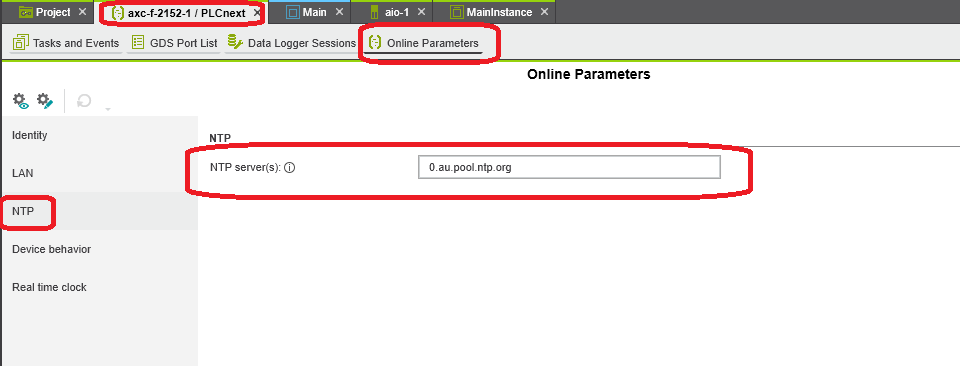

I just tried this NTP setting in PLCnext Engineer, hoping it might unexpectedly resolve an unrelated issue I’m experiencing, but naturally it wasn’t the solution.
I find it odd that this option even exists in PLCnext Engineer when the same functionality is already available in the Web-Based Management system. Having duplicate configuration options in different interfaces seems unnecessary and could potentially lead to conflicts or confusion about which setting takes precedence.

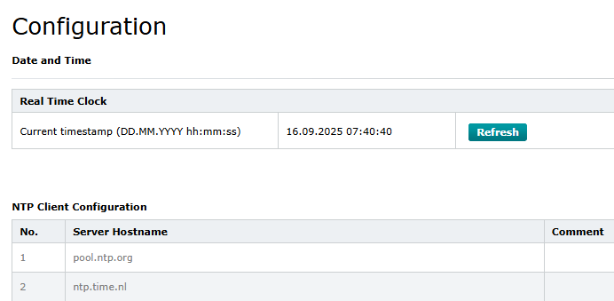

Have you seen or used this option inside the WBM: Configuration > Date and Time?

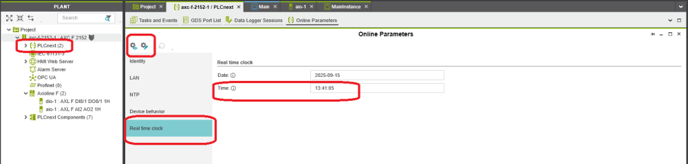

Yes, I put NTP as well in WBM, but I believe NTP setup is not effecting, the most important thing is synchronous your time using PLC read/write time, I tried to sync it with error max one second.
