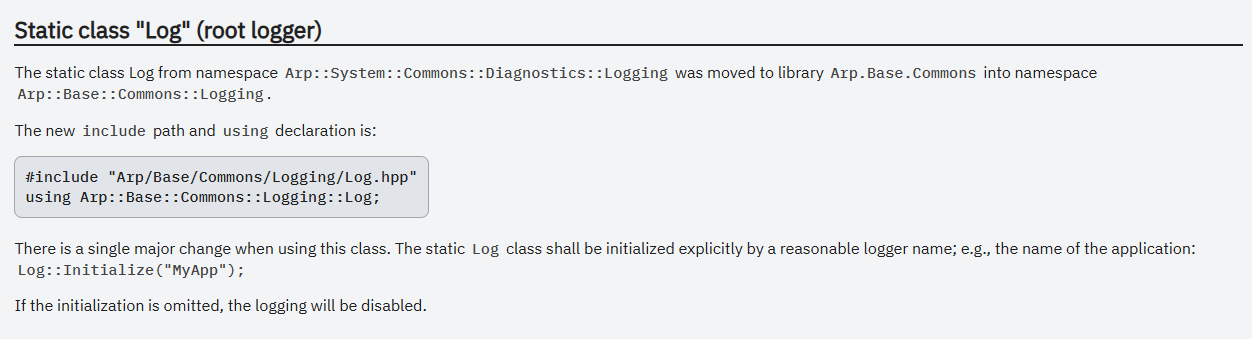

If you are using the static Log class, then the class must be explicitly initialised:
(source: Changes: Miscellaneous )
On the other hand, if you are using the Loggable<> template then initialisation is not required and the messages should appear in the Custom.log file.
