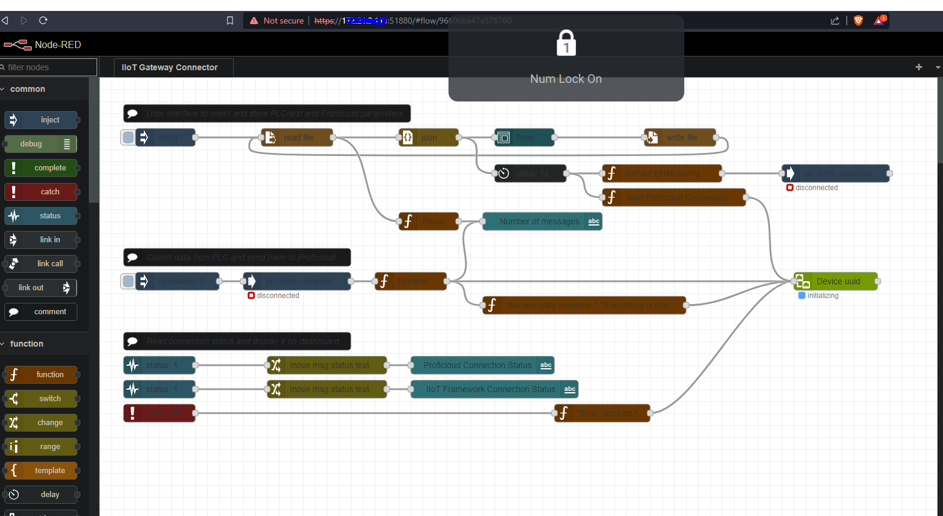

Hi
To be more clear I´m using the ip adress of the AXC F 2152, https://192.168.1.10:51880, but it does not work.
in my case I had to do a factory reset because I already had node red installed and sometimes you have to wait a very long time for node red to load from the plcnext store
I don’t know why but node red in plcnext is terribly buggy but installed in balena it works very well but it would be useful to have instructions on how to do it via docker opc server works very well but uaexpert now does not show changing tags but it works and changes what I want
insturction how to install on belena
https://www.plcnext-community.net/makersblog/node-red-and-getting-started-with-docker/
