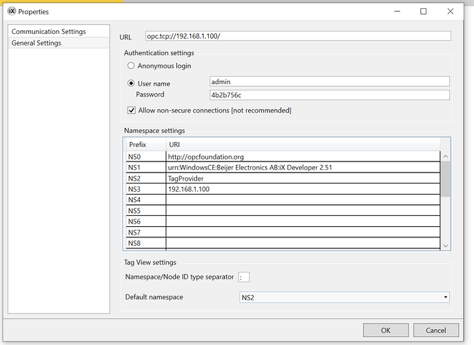

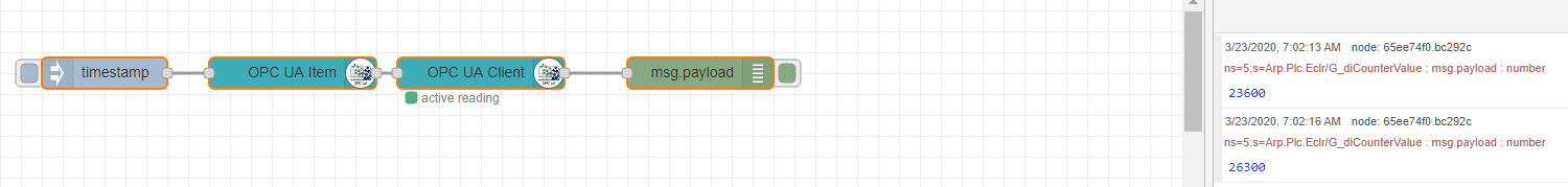

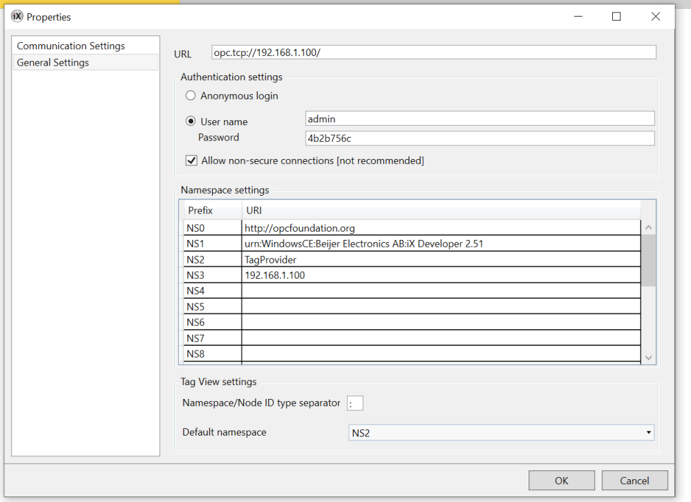

Other node-red options do work fine. Only if I want to connect with OPC UA then it will crash. With node-red on my windows pc I can make a connection with opc ua and it works fine without problems. See photos for more information. the errors it gives: 3 Mar 10:19:42 - Error: cannot locate certificate file /opt/lib/node_modules/no de-red-contrib-iiot-opcua/node_modules/node-opcua-client/certificates/client_sel fsigned_cert_1024.pem
