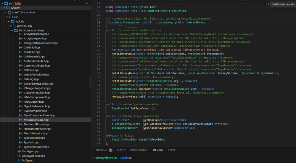

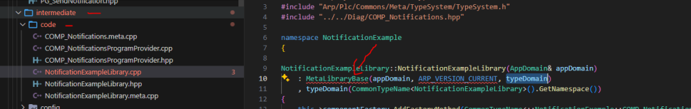

I found other thik which make me a little bit confused on this stage. In the following code snippet, generated by
plcncli generate all
the compilator can’t find prottype for MataLibraryBase constructor. When I serach about MataLibraryBase class deffinition I found only one which do not provide me needed constructor prototype:
where I can find the correct prototype declaration, used in Notification Example ?
