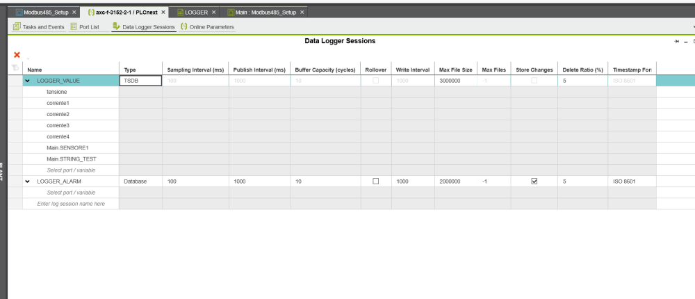

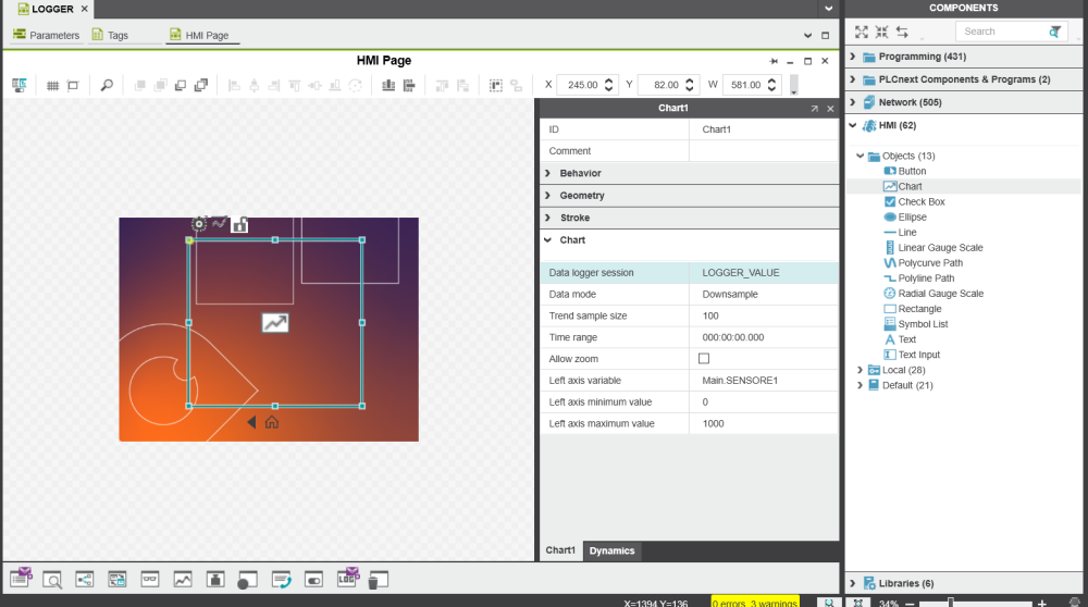

I have correctly configured the data logger parameters in plcnext, if I extract the .db file from the plc with winscp, I can view the data collected by the logger, but when I try to create a chart using the data logger session, the graph does not appear .
I am attaching a screenshot:
datalogger setup
Object Chart in HMI Application
Can you help me ?

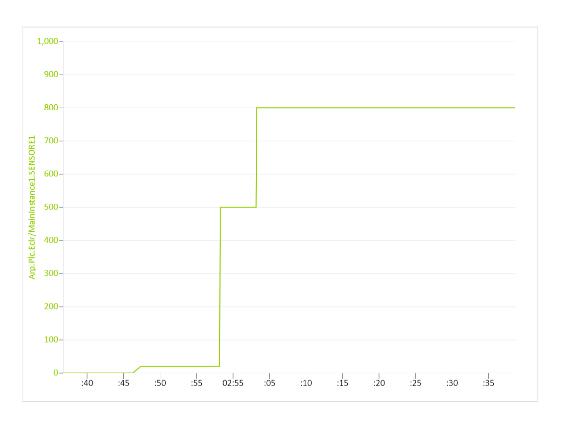

What do you see on the web page?
Hi Martin, thanks for your reply, I do not see anything on the web page, the graph does not appear, nor the abscissa and ordinate axes, the page is blank.
Yes, SENSORE 1 Is a INT. Can you telo me how did you define SENSOR1, Local or external?

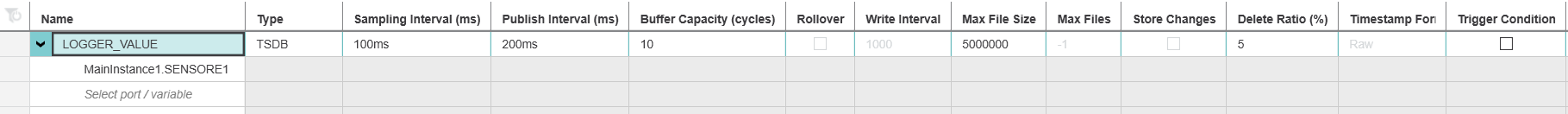

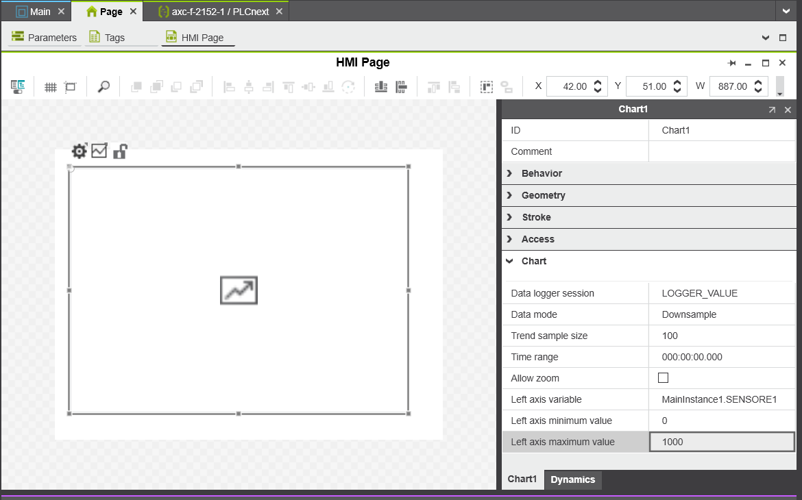

I set up a project, then I created the datalogger session, defined an INT variable and created the HMI page with the graph, but when I load the Web Based view the page is blank.
I attach screenshots if it helps.
I have updated the plcnext version to 2022.0.9 and the plc controller at 2022.0.5 .
variable type INT.PNGdatalogger_session.PNGchart HMI.PNGand finally the HMi web based view

Is it only the Chart object that does not display? Do simpler objects like Text fields appear on the web pages?
yes sure , my HMI app is composed by 8 pages , and work everything well, so yes it’s just chart object does not work .
I solved , Simply check the Plcnext Project version, in my case, i started the project with 00/2020 , and so i must replace the controller version , from Component Tab , with the correct version, 00/2022.
Thanks Martin for your help.
