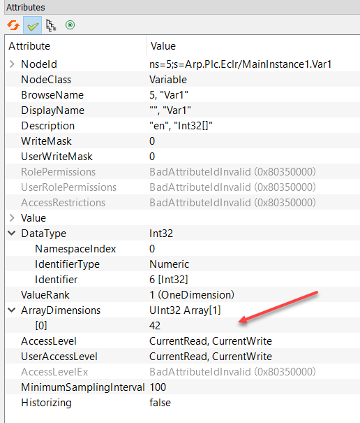

I’m not sure that the type in UaModeler is correct.
When I look at a one-dimensional array with 42 elements in UaExpert, the array has ONE dimension, with 42 elements in the first dimension:
Your screen shot from UaModeler suggests that it is expecting an array with 42 dimensions, which (unless the terminology is not used consistently) isn’t the same as a 1 dimensional array with 42 elements.
I’m not very familiar with UaModeler, but I hope this gives a clue.
Hmm, looking at this again, I don’t think my earlier comments were correct - I am not sure how one would define the array differently in UaModeler, so perhaps the array definitions in UaModeler and UaExpert are the same.
