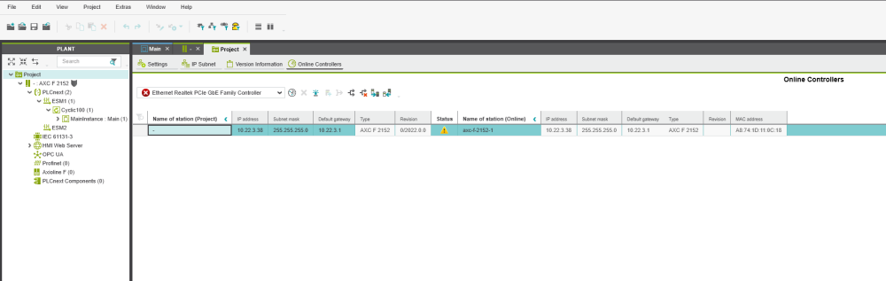

I am trying to add a controller to my project but the controller seems to have no Revision so PLCnext Engineer won’t let me connect to the controller.
But if i look on the webpage of the controller there is a Revision which is higher or equal to the Revision in the project.
Can anyone help me with this?
The absence of the revision number in the Online Controllers window is a known issue, but it does not affect the ability to connect to the device.
What is the firmware version installed on the controller, that you can see in the Web Based Management window?
How are you connecting to the controller from PLCnext Engineer?
