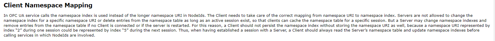

A better solution would be for the OPC UA Client to use the namespace URI instead of a fixed namespace index, which it should do :
C++ Based OPC UA Client/Server/PubSub SDK: OPC UA NodeId Concepts In the old days the classic DA Server have used simple “string”-Identifiers. The so called “ItemID” was a fully qualified name that was unique throughout the whole server (there was only one “namespace”). Furthermore, the classic DA Servers had only capabilities for a simple hierarchy, i.e. a tree-like structure with branches and leaves.
In saying that, it would be strange for two identical devices with identical firmware versions and identical applications running on them, to have different OPC UA namespace lists. Can you confirm that this is the case - identical devices, identical firmware versions, and identical applications?
Hi, as Martin has already posted, the namepace index can change with each connection from the client. The client needs to browse the namespaces of the server and assign the indices accordingly.
A better solution would be for the OPC UA Client to use the namespace URI instead of a fixed namespace index, which it should do :</p>[https://documentation.unified-automation.com/uasdkcpp/1.7.4/html/L2UaNodeIds.html</a></p>[https://forum.plcnext-community.net/uploads/VJUJ5UVZOBBU/image.png</a></p>In saying that, it would be strange for two identical devices with identical firmware versions and identical applications running on them, to have different OPC UA namespace lists. Can you confirm that this is the case - identical devices, identical firmware versions, and identical applications?</p>
