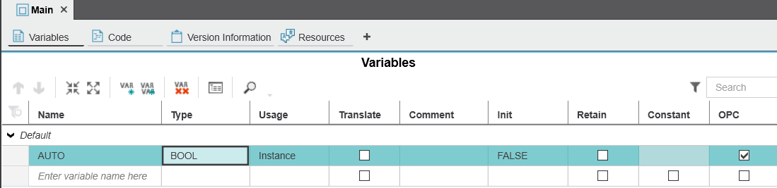

in the variable table of your program you can create a variable AUTO with the usage Instance. If you check the OPC option, the access to the variable is now possible per instance of your program like you described it.
In UA Expert it looks like this:
