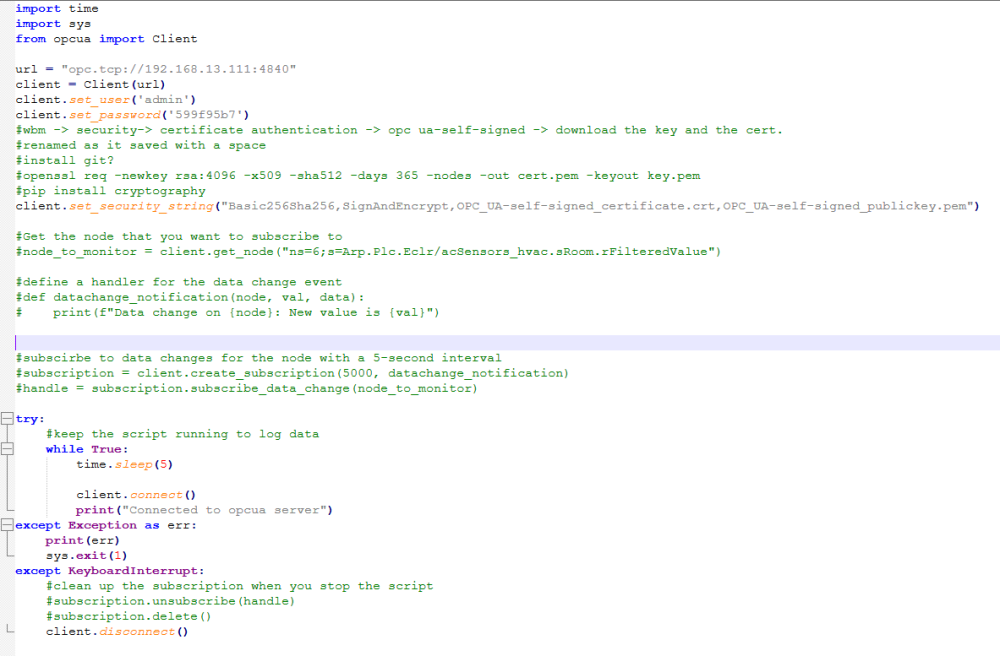

I am trying to write python opc-au client code to communicate to the opc-ua server, however, I cannot figure out the certificates
I have
set up the opc server to be self-signed by the controller (The following article said this would be the simplest to start with) How to use your own Security Certificate with an OPC UA Server on a PLCnext Control - PLCnext Community (plcnext-community.net)
* Gone to the wbm to download the certificates
* Placed the certificates where my python code is stored
* Ran the python code (used similar to: PLCnext-OPC-UA-connect-minimal/connect.py at master · dschoorisse/PLCnext-OPC-UA-connect-minimal · GitHub)
* I am struggling to see a simple way to actually get past / use the certificates so that the python code could actually use it

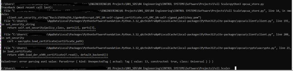

I have also tried to generate my own certificates with the same outcome “ParseError”
I’ve even tried downloaded a certificate to the plc then re-downloading it so that it had the same name.

Ok disabling user authentication worked to confirm that I can connect to the unit
Disabled user authentication, (couldn’t find anything in PLCnext to not allow): NB must reboot
The free server connection also worked with no username, password or certificate.
  1. Yesterday I did try to use that example’s certificates → tried to upload them to the identity store.
    → They are .der files and the controller wants pem or crt
I tried to load back the security, it rebooted but now the password doesn’t work (wbm just reloads each time)

3) Redownloaded the certificate I just made and saved
Gave the usual asn1 parseerror

In relation to certificates, this should be all that’s needed:
image.pngHow to convert a certificate into the appropriate format If your server/device requires a different certificate format other than Base64 encoded X.509, a third party tool such as OpenSSL can be used to convert the certificates into the appropriate format.
* If you’re connecting to the OPC UA server using an IP address in the URL, then in the PLCnext Engineer OPC UA Server settings you should change the Endpoint field to the IP address that you’re using in the URL. This will prevent the server certificate from being rejected by the client due to the URL not matching the contents of the server certificate.
* Please also make sure that “Visibility of variables” is not set to “None”.
After making those changes, send the PLCnext Engineer project to the PLC, to update the self-signed server certificate.
* In web-based management, the client certificate should be loaded to the OPC UA-configurable Trust Store on the PLC.
* The OPC UA-self-signed server certificate should be downloaded from the Identity Store on the PLC (using web-based management) and given to the client application.
If the format of any certificates needs to be changed, you can do this using the openssl command-line tool:
(the OPC UA server certificate downloaded from WBM is a .crt file in PEM format).
The client will also need to provide user credentials during the connection to the server.
I have now gone into this in more detail, and this procedure works:
