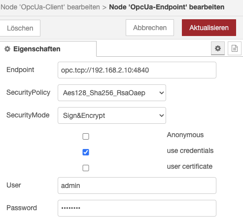

I have a problem establishing a connection to the OPCUA server in the Node-RED app I’ve developed. I’m using the EPC1522 gateway. I’m encountering this issue:
myNodeOpcua.PNGI can establish a connection when I manually start the Docker image I used for developing the app (using ‘docker run’). This leads me to suspect that the error only occurs when I build an app from this image using ‘Podman’.

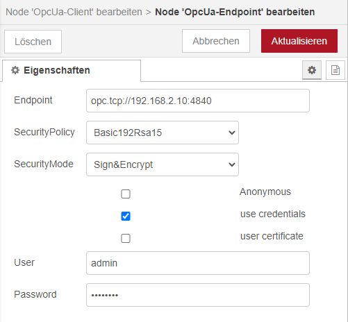

dockerImage.PNGHier ist the Conf Node.
