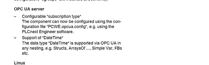

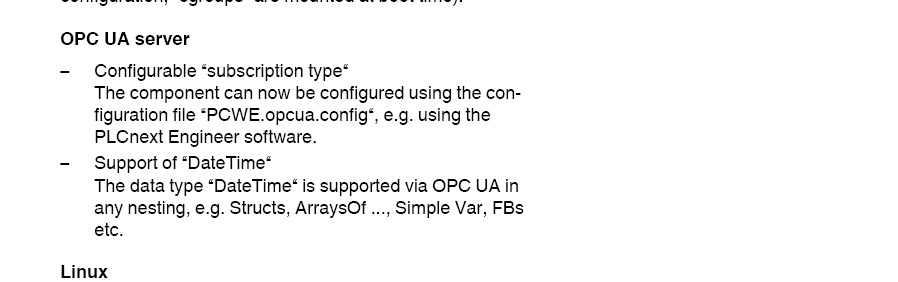

I was working with OPC UA and had established connection between client and PLC next controller (FW : 2020.0 LTS) Via OPC UA and read all the points. We upgraded the firmware of the PLC next controller AXC F 2152 to 2020.3.1 and suddenly all the points are showing error. It seems like the node ID for GDS has been changed from 5 to 4. Are we going to witness changes like this in future updates? Is there a way to still have the Global node Id as “5”? Please confirm. Also the firmware release document talks about some configuration of subscription type and support for date and time. After going through new version of PLC next Engineer and reading help docs, I was not able to locate those settings. Please direct me to where I can configure this, Thanks

Also the firmware release document talks about some configuration of subscription type and support for date and time". Please Direct.
The Subscription Type feature is described in the Info Center, here: https://www.plcnext.help/te/Service_Components/OPC_UA_Server/OPC_UA_server_configuration.htm (near the end of the page) As mentioned in the Info Center, the Subscription Type feature is not supported in PLCnext Engineer version 2020.3, so for the moment this must be configured manually. The DateTime feature simply means that any PLCnext Engineer variable of type
LDATE_AND_TIMEis now handled correctly by the OPC UA server, including in any complex type e.g. array or struct. ~ Martin.
