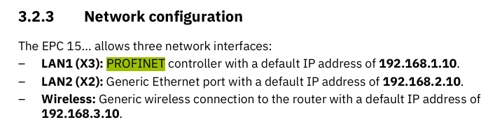

  1. Maybe you should try to use LAN1 (X3) for the PROFINET communication, like it is specified in the user manual.
    Also, the default IP address for LAN2 (X2) should be 192.168.2.10
    Maybe you should do a factory reset and try this again.

I’m using X2 for profinet because the EPC1502 is used as Device in this application (from system services, PN controller is disabled, PN device enabled). X3 is for PN controller usage.
The network IPs and structure are given, not freely reconfigurable, so I can’t change to 192.*

You should use LAN1 also for PROFINET device.
Just swap the cables and network configuration between LAN2 and LAN1.

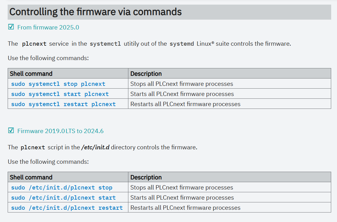

  • what would be a way to control the start/stop of the OPC-UA Server service? Can’t find it in the standard /etc/init.d

The Profinet standard mandates the use of DCP in every Profinet device. Since a compliant device cannot have DCP disabled, there is no mechanism to do this in a PLCnext Control device.
The OPC UA server is not run as an init.d (or systemd) service, which is why you can’t find what you’re looking for. Instead, the OPC UA server is run as a component of the PLCnext Runtime service. It’s not possible to enable and disable the OPC UA server component without restarting the PLCnext Runtime service.
@Martin_PLCnext_Techn thank you, all clear now!
alternatively, in case we ever need it again, is there a SysV way via init.d or else to restart the PLCNext Runtime service?
