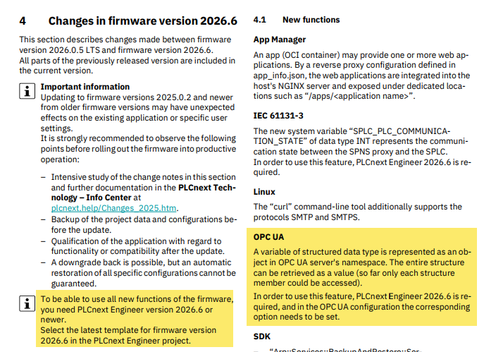

A brief update on this topic:
Source: Release notes for AXC F 2152.
Now we just need to wait for PLCnext Engineer version 2026.6, which is currently scheduled for release in the next few weeks (but that might change).
