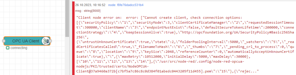

I’m experiencing issues connecting to the OPC UA server in Node-RED on the Gateway EPC1522. When using the official Node-RED app from the PLCNext Appstore, I encounter the following error message:
Here is the configuration of the OPC UA Client Node:

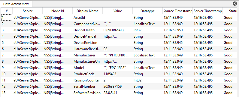

but UaExpert displays data from the Gateway:

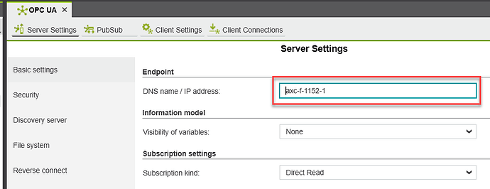

In the OPC UA Server settings in PLCnext Engineer, the Endpoint name ends up in the self-signed server certificate:
Please set the Endpoint name to the IP address of the PLC (which looks like 192.168.2.10), if you haven’t already. Then send the project to the PLC again, and retry the connection.

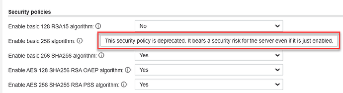

Also, it would be worth choosing one of the more secure security policies. Note the warning in PLCnext Engineer about the one you’ve chosen:
Change the security policies has solved this Problem
