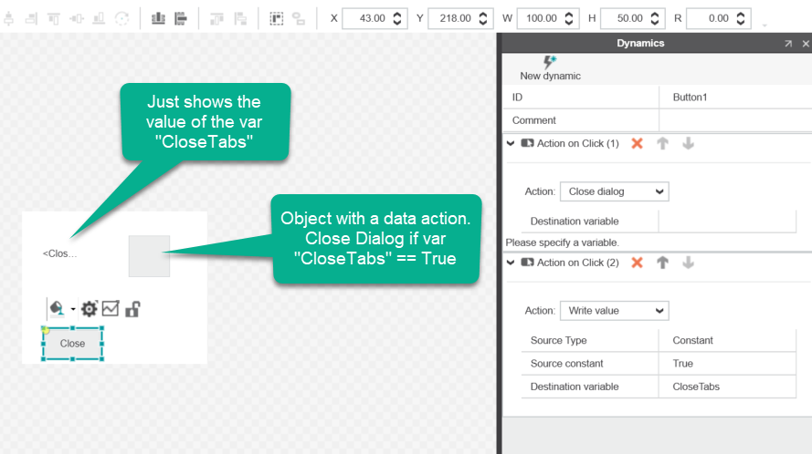

Hi Arne, there is no ready made button available, but you can use a data action to close the pop ups. Attached a screenshot from what I’ve made. - There is a Variable “CloseTabs” - This variable is set to false with the calling buttons on the main page - This variable is set to true from every (or just some) buttons on the pupup - A data action on one of the objects on the pop up checks the variable “CloseTabs” → True → Close Dialog - Every chained popup with this (maybe hidden) object will than close right away Hope this works also for you. BR, Frank
