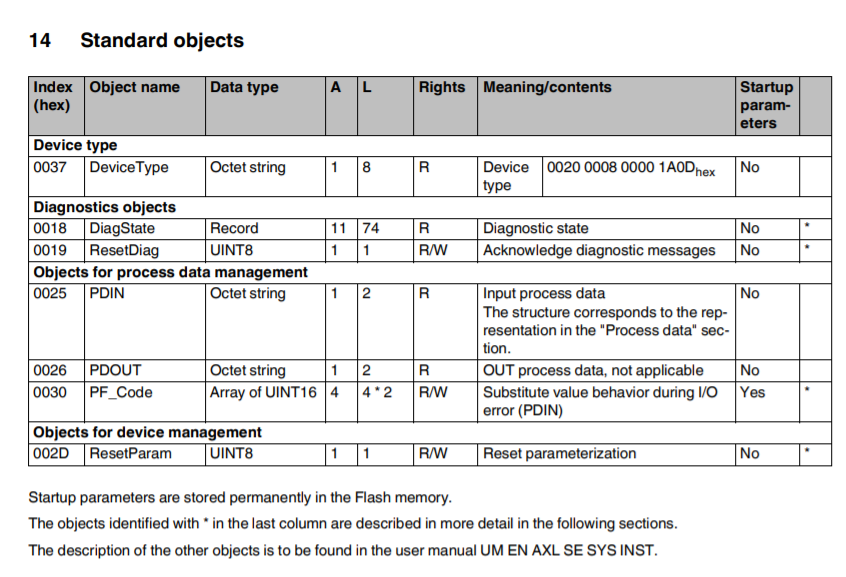

Hi Dominic, I’m probably missing something … where do you see that 16#0007 is the index corresponding to Product Name for the AXL SE AI4 U ? I have attached the section of the AXL SE AI4 U user manual that I am looking at, and even when I follow the references to the other Axioline manuals, I can’t see this PDI Index listed for this module. If you can confirm that this is a valid PDI index, then I will investigate further. ~ Martin.
