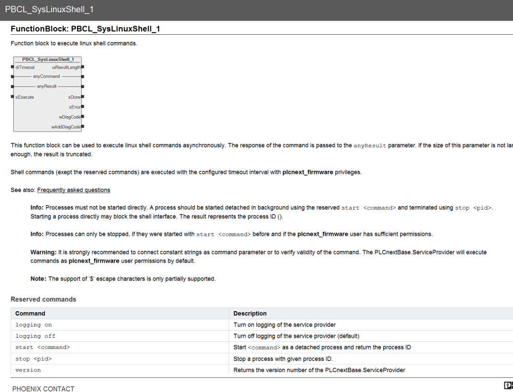

PBCL_SysLinuxShell from the PLCnextbase library.
PBCL_SysLinuxShell from the PLCnextbase library.</p>[https://forum.plcnext-community.net/uploads/E8FXQJ461T99/image.png</a></p>
Thanks, by any chance to you have the especific command so I could have a return in case the device is not reachable. I tried using ‚start ping ipaddress‘ and just have the process ID as a return and in case it desconnects the FB does not returns an error.
