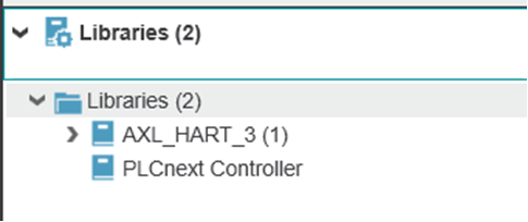

I have used PLC AXL F 2152 with Analog HART(AXL F AI8 HART XC 1F ) but I do not know how to configuration wiht HART device ? how to monitor data from HART device via AXL F AI8 HART XC 1F .

Hi Sophearak,
On PLCnext engineer, have you added the hart AXL_HART on the library to collect the HARD data on each channel?
