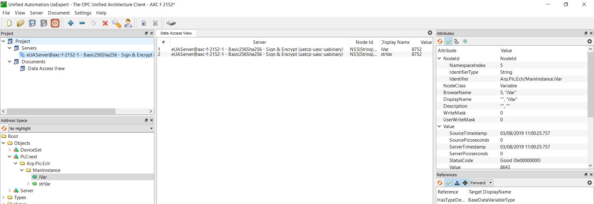

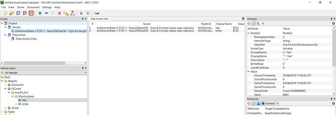

In UaExpert, you can see that two things are needed to connect to the server in the PLC:
                                          1. A username and password.
                                          2. The server certificate must be trusted. This can be done by putting the server certificate in UaExpert's "Trust Store".
For the Grafana plugin, it looks like one or both of these steps are failing. I don’t know if the plugin is providing the username and password to the server; and I don’t know how to tell the plug-in to trust the server certificate, e.g. I don’t know where the “Trust Store” is for this OPC UA client. I tried installing the server certificate in the Windows certificate store, but that didn’t help.
I suggest that you contact the developer of the plugin and explain that the connection to this OPC UA server can be made perfectly well with UaExpert, but not with the Grafana OPC UA plug-in.
