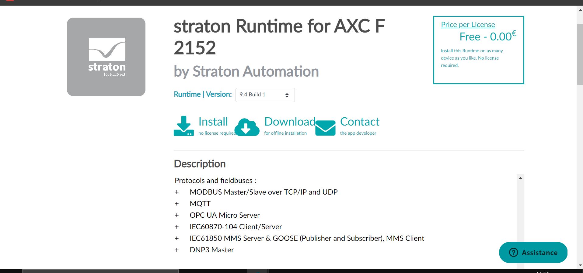

Dear Members, SmartRTU is a proposal and is a very accurate product if you are looking for paramétrization instead of programming. If you are more looking for programming : IEC61850 is available over PLCNext thanks to straton by Copa Data . This solution enables Client and Server communication and of course MMS & GOOSE messaging. STRATON app allows also some others “energy” communication protocols such as IEC 60870 104. Please have a look to PLCNext Store : contributor is STRATON AUTOMATION By Copa Data. The apps name is “straton” Straton-plcwebsite\thttps://straton-plc.com/ Movies\thttps://www.youtube.com/channel/UCEbOkLKIVMZKaYPWStXcJug product datasheet\thttps://straton-plc.com/document/datasheets/42.straton_datasheet_PLCnext_Runtime.pdf Jean ROCHE Industry Manager Energy PHOENIX CONTACT SAS France GSM : +33 6 38 10 50 63 mailto : jroche@phoenixcontact.fr

Does it support Goose in Publisher and Subscriber mode? Can it send and recieve goose messages.
