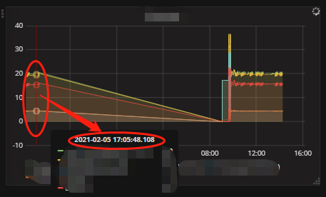

Hello Martin, First of all, thank you for your response to my question in the forum. Attached is the Output.log file about the crash of PLCnext. From the Dashboard of Proficloud below, we can see that PLCnext was disconnected from Proficloud at 2021-02-05 17:05:48 (CST). And never connected again until PLCnext crashed a few hours later. What we have been confused about is why PLCnext does not crash immediately when the network between Proficloud and PLCnext is disconnected, but PLCnext crashes until a few hours later? Now we guess that there is a buffer in PLCnext. When PLCnext disconnects from Proficloud, the data will still be stored in the buffer. But when the buffer is full, PLCnext will crash. (Of course, this is just our guess ).
