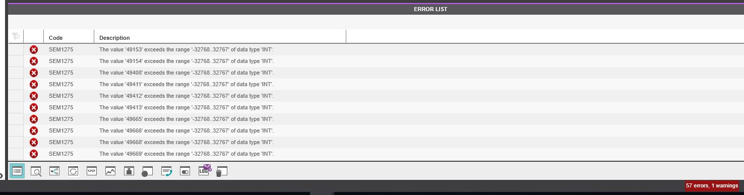

I am working on moving from 2020.6.2 to 2021.0. I have two different projects, both for AXC F 2152 FW2020.6, utilizing many of the same libraries and functions but I get different errors with each of them:
* Project 1: Several instances of: SEM1275: The value '49680' exceeds the range '-32768..32767' of data type 'INT'
* Project 2: Single instance of: UTL0001: Internal error.
Any guesses as to what the issue could be? Thanks, Rob H
Project 1: Several instances of: SEM1275: The value ‘49680’ exceeds the range ‘-32768..32767’ of data type ‘INT’

Hi I think I got the same problem on my PLCnext 1152 project. Can you show me how to solve this problem? And will I got this problem everytime I want to upgrade the software? Errormessage: SEM1275 The value ‘49153’ exceeds the range ‘-32676..32767’ of data type ‘INT’
Hi pudderjagar, As Oliver mentioned, there is a relatively new compile time protection mechanism that can generate this error. Please try declaring the problem variables as UINT instead of INT. [quote]will I got this problem everytime I want to upgrade the software?[/quote]No, once the problem is fixed in the project, this error will not appear again for the same project in future versions of PLCnext Engineer.
