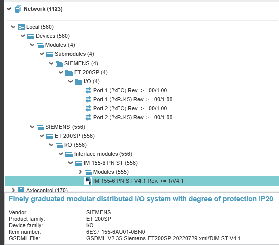

I faced with some troubles while import Siemens profinet distributed station from GSDML file.
GSDML-V2.35-Siemens-ET200SP-20220729.xml from official storage. It was only one option of import selected.
As result, all available memory was consumed by IDE, it get freezed, and there is no opportunity to continue work…
For this ET station there are alot of modules avaliable, so probably this is the reason of this behavior?
Can some one suggest me, does I need more productive machine (more RAM) to continue work with this project, or this is some kind of malfunction of IDE.

I was able to import the file on a system with 32GB RAM.
The IDE ended up using 17GB RAM after the import finished.
One might wonder why 27MB of device description results in 17GB RAM usage…
